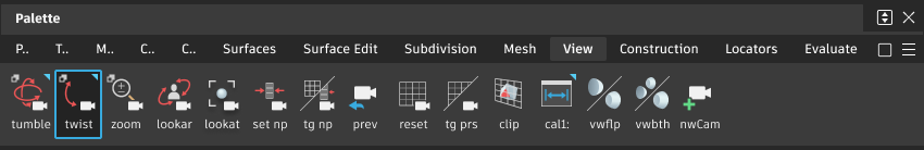

Access this tool from the View palette:
  • To tilt the drag with the mouse, or type the twist angle and press Enter.
    Dragging the mouse to the right rotates the view counter-clockwise, and dragging to the left rotates the view clockwise. Dragging across the whole window rotates the view 360 degrees.
