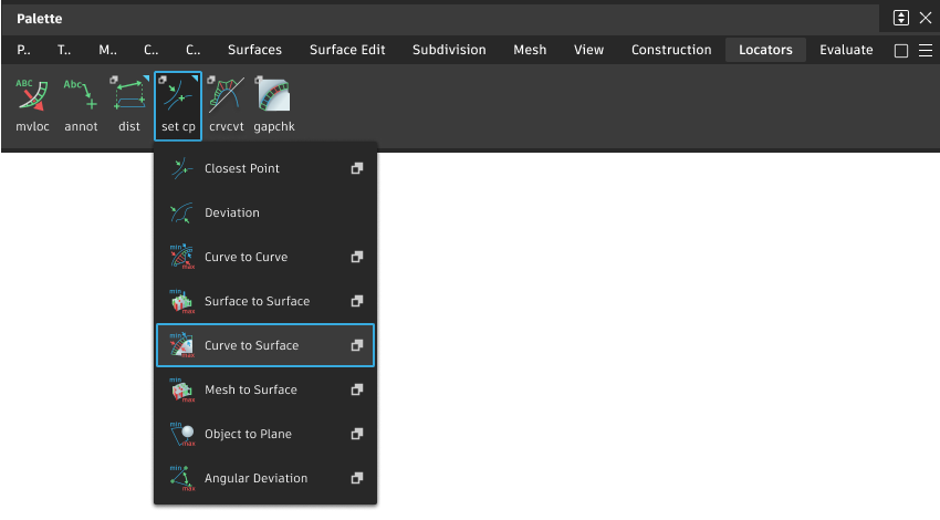

Access this tool from the Locators palette:
