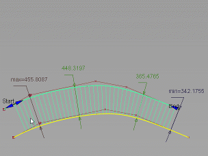

Adds a measurement showing the minimum and maximum deviation between two curves. This tool creates a locator showing the deviation between the two objects, labeling the minimum, maximum, mean, and displaying a deviation comb indicating the deviation across the length of the objects.
When selecting curves for measuring deviation, the selection order can make a difference in the curve-to-curve deviation results.

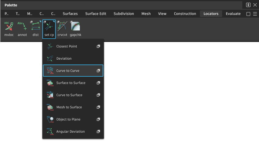

Access this tool from the Locators palette:

Show Min / Show Max / Show Mean / Show Comb
Check/uncheck the boxes to turn the different labels and comb on or off.
The labels can also be toggled on/off from the Information Window.

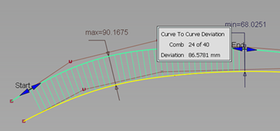

When Show Comb is on, you can right-click a comb sample in the viewport to display the deviation value at that point. See Display deviation values in the viewport.
Projected deviation locators include angled brackets around the values, for example, min=<2.1234> max=<7.981>.
Modify Range
Modify Range
Turn this on to specify the start and end points of the curvature comb.
Use this option to limit your deviation measurement to specific areas of the curves. Enter Start and End values or use the in-canvas manipulators to set the start and end points for the comb.

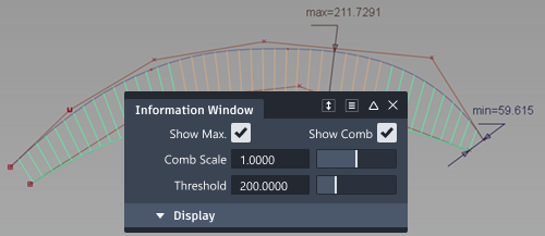

Threshold
Lets you set a value between the Min. Dist. and Max. Dist. range to trigger the threshold deviation display. When the deviation between two curves is higher than the set Threshold value, the locator turns from green to orange. This way, you can quickly see where the deviation between to curves exceeds the desired limits.
Right-click a comb sample to display the deviation value at that point.
click anywhere along the length of a curve to add another measurement point. Shift +
on a measurement point to remove it.
