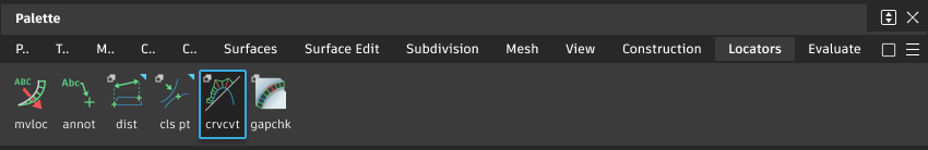

Adds a locator that shows the curvature or radius comb of a curve.
Access this tool from the Locators palette:

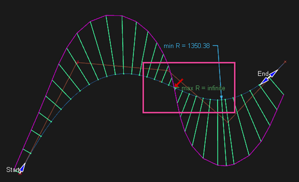

Inflection Points
Show the inflection points on the curve with small red arrows. The Max Radius value at the inflection point is displayed as infinite.
To speed up display, the arrows are only close approximations. To see the true inflection point, look for the point where the comb outline crosses the curve.

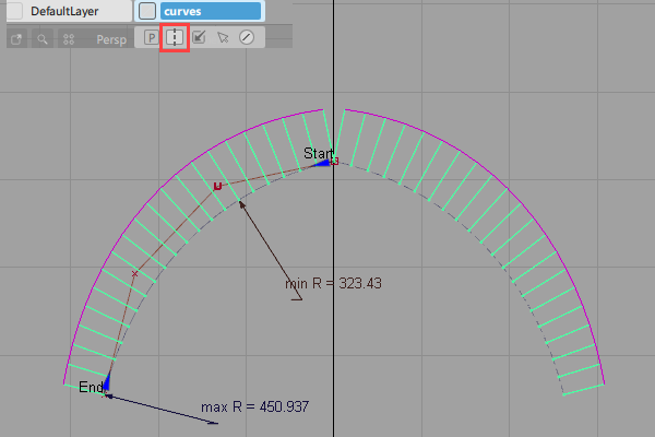

Min Max Radius
Indicates the points of maximum and minimum radius of curvature.
Note: Starting Alias 2025.1 Update, the Max and Min Radius values displayed in-canvas are more accurate. They are no longer dependent on the sample density of the curvature comb plot. This means that the tool now produces Max and Min Radius values that may be different than in other versions of Alias.

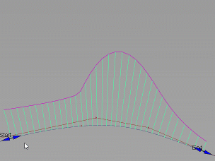

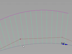

Modify Range
Modify Range
Turn this on to specify the start and end points of the curvature comb.
This option is helpful when curvature combs overlap, such as when you are adding acceleration. Use it to correct this issue by defining a start and end to the combs so that they does not obscure the display of the curve as you adjustments.
Enter Start and End values or use the in-canvas manipulators set the start and end for the comb.

    If the curves are on a layer that has Symmetry turned on, the combs appear on the symmetric geometry as well. If Min Max Radius labels are turned on, they only appear on the original geometry.
  3. Drag the mouse to change properties of the curvature comb:
    • Drag the to change the scale of the quills.
    • Drag the to change the sampling density of the comb.
    • Drag the Start and End manipulators to specify a range for the comb start and end points. You can also enter Start and End values under Modify Range.

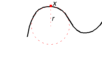

Curvature is a measure of how much a curve curves.
curvature1
Curvature is measured by fitting a circle into the curve, then taking the reciprocal of the radius of the circle. In the illustration, at point x, the curve is best described by a circle with radius r. At this point, the curvature is 1/r.
(We use the reciprocal, 1/r, instead of just r because a flat line has an infinite radius. Taking the reciprocal gives us 0 instead of infinity.)

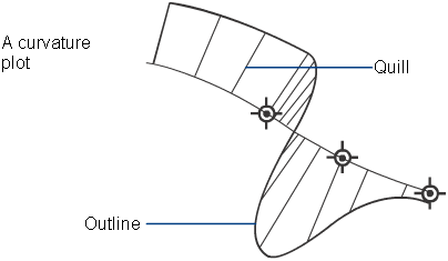

About_composite_graphics0012
Several tools in Alias, such as the Curve Curvature tool tool, allow you to display a comb plot of a curve’s curvature. At regular points along the curve, the tool samples the curvature, and draws a line (sometimes called a “quill” because it looks like a spine on the back of a porcupine). The length of the line represents the curvature value at that point.

Find inflection points
Turn on the Inflection Points option in the Information window. Inflection points are marked approximately with blue arrows. To find the exact inflection point, zoom in to the point where the comb outline crosses the curve.
What are inflection points?
Inflection points, also called ogees, are the points on the curve where the curvature changes direction.
