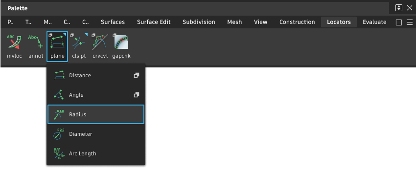

Adds a radius or diameter measurement to a curve.
Access this tool from the Locators palette:
Measure Radius tool workflows

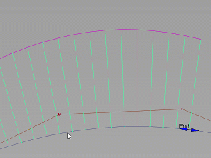

Display all the radius values along a curve
To see a continuous comb plot of radius values along a curve, use Locators > Curve Curvature
with the Plot Value option set to Radius.To see radius values at specific locations along the curve, Shift-click the curve. Shift-click a radius callout to delete it. Radius values can be displayed this way regardless of the Plot Value option you have selected.
