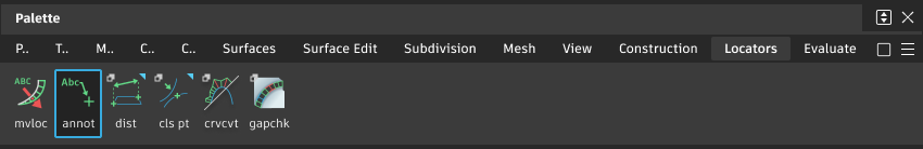

Adds a label with a leader to a point.
Access this tool from the Locators palette:
