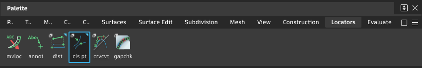

Access this tool from the Locators palette:

Select the Closest Point tool.
