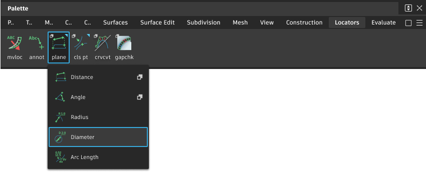

Adds a radius or diameter measurement to a curve.
Access this tool from the Locators palette:
Measure Diameter workflows
Measure the diameter of a circle
Select the tool.
Click the circle you want to measure.
The locator appears. You can move the new measurement while the mouse button is down. When you release the mouse button, the measurement is attached to the circle.
