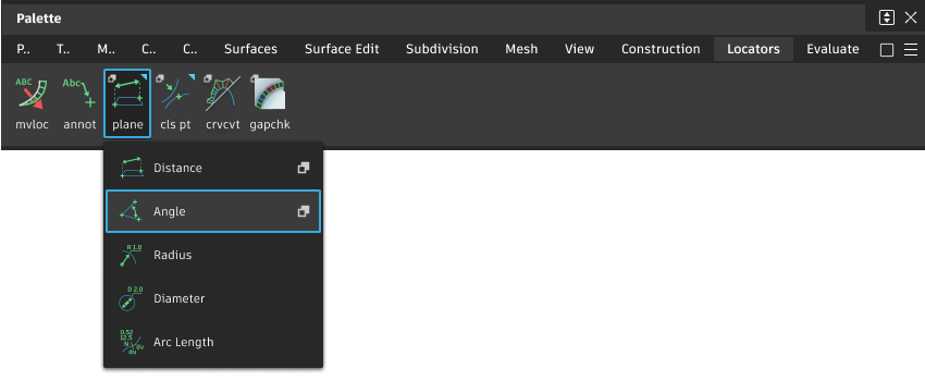

Measure Angle
Adds a locator that shows the angle between three points.
Access this tool from the Locators palette:
