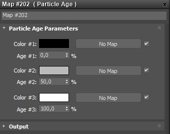

Particle Age
The Particle Age shader is implemented as a native Arnold shader in MAXtoA_Shaders.dll
Info: All features are supported exactly as documented in the 3ds Max documentation.
