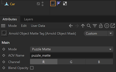

  • Arnold Object Matte tag: The Arnold Object Mask tag is renamed to Arnold Object Matte and new Object ID and Custom Material modes are added. The Arnold Custom AOV tag is removed, use the Custom Material mode in the Arnold Object Matte tag instead. (C4DTOA-3359)
  • Puzzle Matte: You can now write out Puzzle Matte AOVs from the Arnold Object Matte tag. (C4DTOA-3358)
