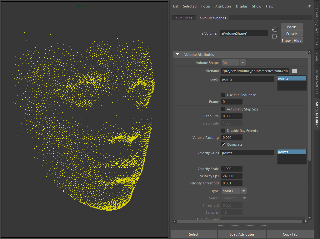

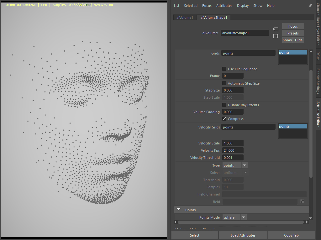

functions are called. (ARNOLD-15898)Viewport proxies for points, polymeshes, and volumes:
AiProceduralViewport()
now accepts non-procedural nodes such as points, polymesh, and volume, and returns viewport proxy representations. (ARNOLD-15941)
Volume points displayed and rendered in the viewport
