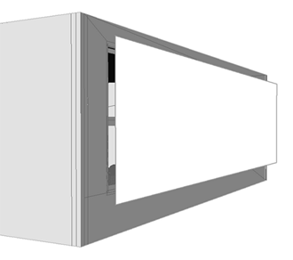

- Start off by creating a polygon plane and position it so that it covers the area of the windows outside the room.
- Assign a Standard Surface shader to the plane. Increase the Emission Scale to 0. We want it to be purely emissive, so it is good practice to reduce the Base Weight value to 0.

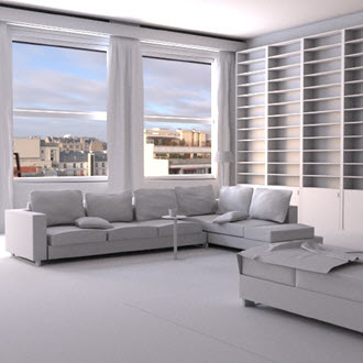

Adding an HDRI map to the Emission Color of the Standard Surface shader is another option to light the scene.
| HDRI assigned to Emission Color of Standard assigned to plane outside window | HDRI in window appears blown out |

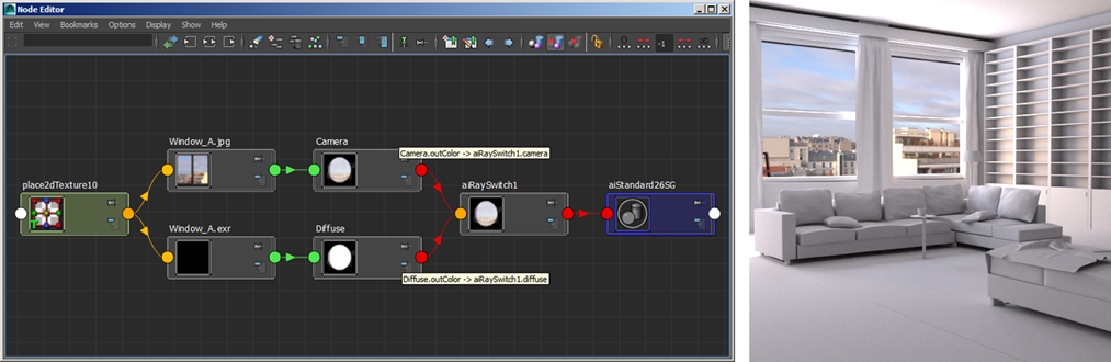

The window HDRI appears blown out when assigned to the emissive plane. A way around this is to use the Rayswitch shader. A Standard Surface shader with the HDRI image is used to control Diffuse Rays and another Standard Surface that contains the same image as a JPEG is used for the camera rays.
Rayswitch shader assigned to emissive plane geometry. The window JPEG texture is visible to camera rays, while the HDRI is visible in diffuse rays
The window HDRI appears blown out when assigned to the emissive plane. A way around this is to use the Ray Switch shader. An Standard Surface shader with the HDRI image is used to control Diffuse Rays and another Standard Surface that contains the same image as a JPEG is used for the camera rays.
Ray Switch shader assigned to emissive plane geometry. The window JPEG texture is visible to camera rays, whilst the HDRI is visible in Diffuse Rays
