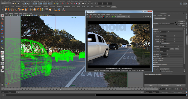

Example of a crowd of cars generated with the Geometry Behavior
Caution:
Notice that Geometry Behavior animation is not always supported correctly by the Render Previz display mode. To see the result of a Geometry Behavior, it's advised to render the frame instead.

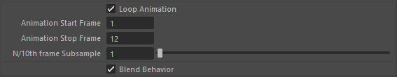

These parameters control the way the geometry file is played (if it is required to be played):
Geometry animation attributes of a Geometry Behavior
Loop Animation If this box is checked, the geometry animation will loop automatically when it reaches the Animation Stop Frame. If not, the last frame of the animation will be played until the behavior is stopped
Animation Start Frame Frame at which the animation will start
Animation Stop Frame Frame at which the animation will stop/loop.
N/10th frame subsample Controls at which rate the geometry must be subsampled (useful for motion blur). Valid range is 1/10 (keep tenth of frame information in cache for motion blur) to 10/10 (full rounding in cache).
Blend Behavior If this box is checked, the geometry animation will be blended with the animation generated by other behaviors (such as CrowdBeMotion…). If not, the geometry animation will be played as it is stored in the geometry file.

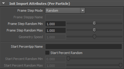

Init Import Attributes (Per Particle)
Init import attributes (per particle) of a Geometry Behavior
Frame Step Mode This attribute allows a choice of three speed modes:
Frame step modes of a geometry behavior
  • Per particule attribute: Use "Frame Steppp Name" attribute to get the name of the float per-particle field of the relative particle system, containing the frame step which will be applied on the source geometry per frame (per default, one geometry frame played per simulation frame). To learn more about per particule attributes, see ppAttributes Handling.
  • Random: The source geometry frame step will be taken randomly between the specified "Frame Step Random Min" and "Frame Step Random Max". This attribute is influenced by the random seed of the Crowd Manager
  • Automatic: The source geometry frame step will be automatically computed according to the Entity speed. As it's not possible to determine the complete translation of the character in the geometry file, you must specify the "Geometry Speed" (meaning the translation of the character in meters/second).
Frame Steppp Name See above
Frame Step Random Min See above
Frame Step Random Max See above
Geometry Speed (in m/sec) See above
Start Percentpp Name Name of the float per-particle field of the relative particle system, containing the value of the start percent in the animation (between 0. and 1.). If none is given and if the Start Percent Random box is not checked, the motion will start at its beginning (0.). To learn more about per particule attributes, see ppAttributes Handling.
Start Percent Random If this box is checked, the motion will start at a random time between the specified "Start Percent Random Min" and "Start Percent Random Max". This attribute is influenced by the random seed of the Crowd Manager
Start Percent Random Min See above
Start Percent Random Max See above

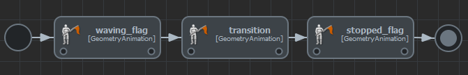

Transitions between several Geometry Behaviors
Notice that when sequencing two Geometry Behaviors, Golaem Crowd is not able to compute a transition between the two behaviors. It's up to you to provide a transition Geometry behavior in between if required (see image below).
