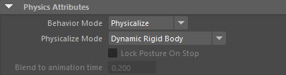

Physics Attributes
Physics Attributes of a Physicalize behavior
Behavior Mode
Select the behavior mode:
  • Physicalize: activates physics simulation for the specified Body Parts (see below) of the Entity.
  • Dephysicalize: deactivates physics simulation for the specified Body Parts (see below) of the Entity.
Physicalize Mode
Select the physicalization mode (in the case of Behavior Mode is set to Physicalize):
  • Dynamic Rigid Body: the Entity (or the selected Body Parts, see below) is controlled by physics simulation
  • Kinematic Rigid Body: Switch back a Dynamic Rigid Body mode Entity (or the selected Body Parts, see below) to the default animation mode, where it can be controlled by Kinematic behaviors (Motion, Locomotion, IK...)
  • Local Servo Rigid Body: the Entity (or the selected Body Parts, see below) is controlled by physics simulation, but a torque (a rotation force) is applied on each joint to keep the local orientation of the currently played animation
  • World Servo Rigid Body: the Entity (or the selected Body Parts, see below) is controlled by physics simulation, but a force and a torque are applied on each joint to keep the world positions and orientations of the currently played animation
Lock Posture on Stop
Available only when Behavior Mode is set to Dephysicalize
If checked, the Entity keeps playing the last posture infinitely (very useful for dead characters who should stop moving). If not, the Entity goes back to its neutral posture or play some motion (if a Motion or Locomotion Behavior is running)
Notice that when the Entity is dephysicalized, it can not be used as a collider with other Entities any more. If you want to freeze an Entity and keep it in the physics simulation as a collider, see the Static Body Physics Mode above.
Blend to animation time
Available only when Physicalize Mode is set to Kinematic
Time during which the ragdoll posture will be blended with the animation when switching back from dynamic to kinematic mode. This allows a smoother switch when recovering from ragdoll to animation.

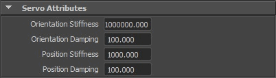

Servo Attributes
Servo Attributes of a Physicalize Behavior
Orientation Stiffness
Stiffness used to compute the torque to apply on a rigid body to reach the current animation posture.
The greater this parameter is, the more similar to the animation the rigid body orientation will be and the more responsive the animation is.
But with great power comes great instability. Use Damping to fix the instability once you find the expected responsiveness.
Orientation Damping Damping used to compute the torque to apply on a rigid body to reach the current animation posture.
The damping part ensure the computed torque will not result in higher velocities than the animation velocity and helps stabilizing the simulation (the highest the value is, the best the stability is).
Position Stiffness Stiffness used to compute the force to apply on a rigid body to reach the current animation posture.
The greater this parameter is, the mmore similar to the animation the rigid body orientation and position will be and the more responsive the animation is.
Position Damping
Damping used to compute the force to apply on a rigid body to reach the current animation posture.
The damping part ensure the computed force will not result in higher velocities than the animation velocity and helps stabilizing the simulation (the highest the value is, the best the stability is).

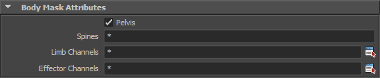

Body Mask Attributes
By default, the Physicalize Mode is applied on the entire body (meaning all joints for which physicalized have been checked when exporting the Character file, see Body Physics Properties). However these physicalized joints list can be filtered by the body mask to change the Physicalize Mode only on specified channels (any joint not in the mask will keep its previous Physicalize Mode, which is the Kinematic mode if no mode was ever applied).
Pelvis
if checked, physics simulation is activated on the Entity Pelvis.
Note that this body part should be checked if you want to drive the global position/orientation of the Entity with physics
Spines List of the spines affected by the behavior. You may specify any spine name as seen in the Motion Mapping Panel of the Character Maker.
Star ( * ) wildcard is authorized at begin or/and end of names (i.e. spine*, *spine, etc.).
Separate the channels names by comma ( , ), leading and trailing spaces will be ignored.
Use the * wild card to use all limbs.
Names are NOT case sensitive (compared as lowercase).
Limb Channels List of the limbs channels to play on the entity. Use the  button to open a window with the name of all the available Limbs for the Character Files loaded in the scene. Those names can also be found in the Motion Mapping Panel of the Character Maker.
Star ( * ) wildcard is authorized at the beginning or/and end of names (i.e. left*, *arm, etc.).
Separate the channel names by comma ( , ), leading and trailing spaces will be ignored.
Effector Channels
List of the effectors ​channels to play on the entity. Use the  button to open a window with the name of all the available Effectors for the Character Files loaded in the scene. Those names can also be found in the Motion Mapping Panel of the Character Maker.
Use the * wild card to use all effectors.
If an effector channel is selected, the corresponding limb channel is automatically added also.
