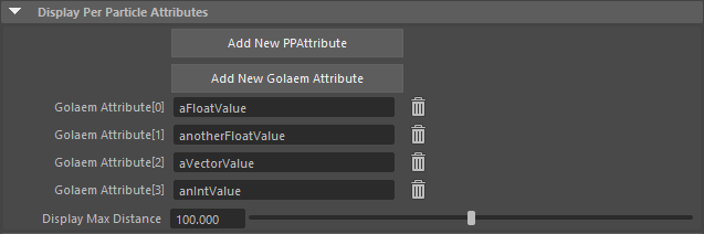

Each Entity Type allows to previsualize Entities simulation in real-time in Maya's viewport. It also supports multiple Golaem Attributes display. In the Entity Surface Shape Attribute Editor / Display Per Particle Attributes panel, you can add the Golaem Attribute names to display:
Setting to display some Golaem
Attributes
Setting to display some Golaem Attributes in viewport

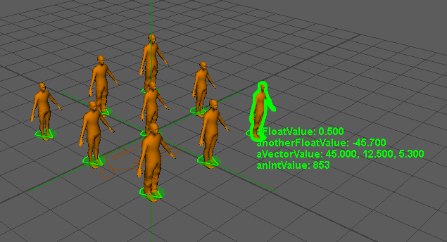

And in the viewport:
Display fo those Golaem
attributes
Display of Golaem Attributes
