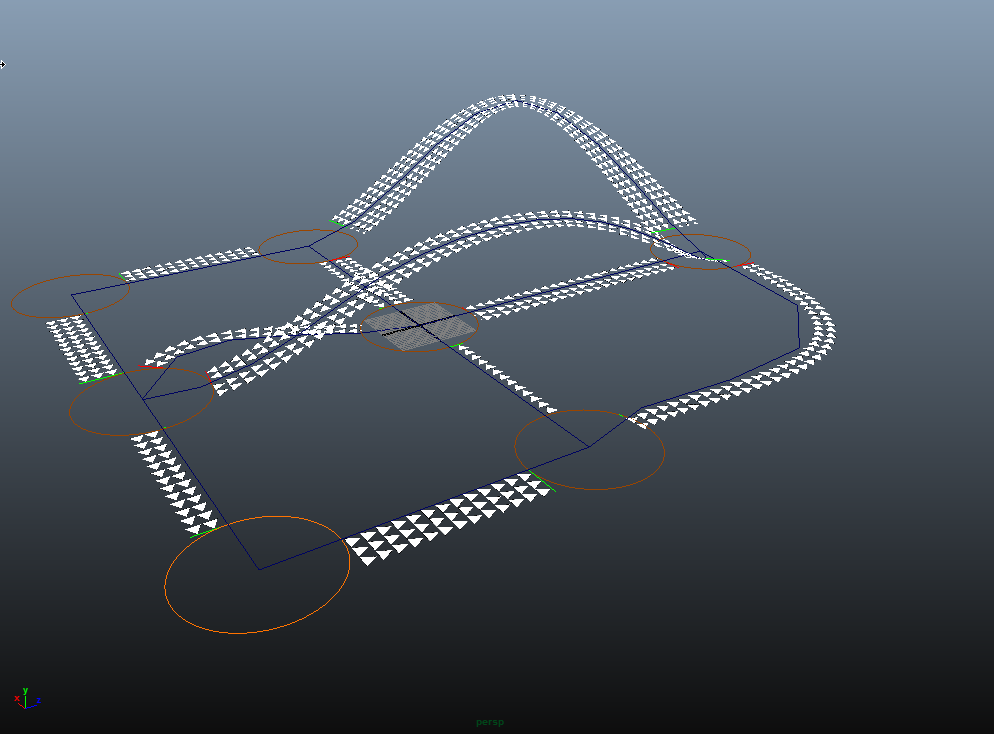

A Traffic Locator display, with lanes on curves, and crossings

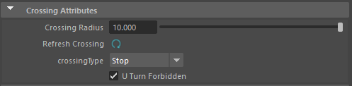

Crossing Attributes
| Crossing Radius | This is the radius inside which a car will start behaving as a crossing. The traffic lights will be positioned on each plugged curve at this radius length. |
| Refresh Crossing | If some curves have moved inside or outside the crossing, it might be require to refresh the display correctly. |
| Crossing Type | A crossing can be one of : Traffic Lights, Junction or Stop |
| U Turn forbidden | In some specific cases, U turns must be avoided (foreground, etc), this attribute insures that there won't be any U turn on this crossing. |

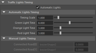

Traffic Lights Timing
Each Road as its specific control for lights. A light status of 0 or less means that the light is red. 1 or more means the light is green, everything between 0 and 1 is orange (acts as red in simulation). The user can decide to take control over it (keyframes, etc), or to let automatic timings to the job.
| Automatic lights | Let the lights control to automatic timings (true) or user custom management (false) |
Automatic Lights Timing
When using automatic mode, the lights will iterate over connected roads. The roads are paired (the best aligned roads are put together, then the two next best aligned roads, etc, until there is only one or two roads remaining). Then the crossing iterate from one pair to the next with the following sequence :
| Timing Scale | Add a scale ratio to timings, to offset lights and avoid too much synchronization |
| Green Light Time | Lights for a pair stays green for the given amount of seconds |
| Orange Light Time | Lights for a pair stays orange for the given amount of seconds |
| Red Light Time | All roads stay red for this time before another pair goes green. |
Manual Lights Timing
| connectedRoad[x] | gives the name of a connected road and its matching light status parameter |
