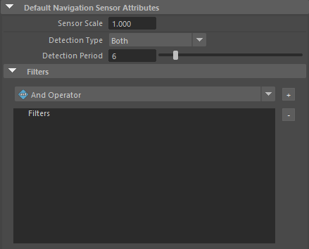

Default Navigation Sensor Attributes
These parameters let you edit the Default Sensor used in Navigation Behaviors
Those attributes are similar to the ones in the Sensors, please check their descriptions Sensor.

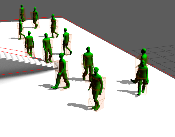

Perception Locator with Display Entities and Display Obstacles enabled
| Display Entities | Draws the Perception Shape voxels of each entity in the perception environment |
| Display Obstacles | Draws all the navigation obstacles in the perception environment |
