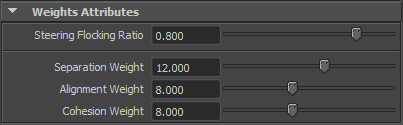

Weights Attributes
Weights Attributes
You can control the global behavior of a flock by giving different weights to each flock goal.
| Steering Flocking Ratio | Depending on the desired result, one can choose to emphasize on steering toward a target (flee/seek/wander), or on flocking effect. A ratio of 0 will negate flocking effect, and just steer toward the current target. A ratio of 1 will only apply flocking effect and won't steer at all. Beware than only applying flocking effect won't move a boid, if it has no other boids in its neighborhood (because no cohesion/separation/alignment can be determined in that case). A ratio of 0.8 is given by default : mostly flocking, while still keeping some steering influence. |
| Separation Weight | Weight of separation in boid final decision. When null, boids will crowd in some points, while great values make them split as much as possible |
| Alignment Weight | Weight of alignment in boid final decision. Try to align boids velocity with their neighbors |
| Cohesion Weight | Weight of cohesion in boid final decision. Try to make boids stay near neighbors |

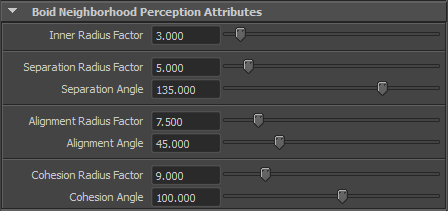

Boid Neighborhood Perception Attributes
Attributes of a flock locator
These are advanced flock parameters. They let you define a custom shape and size for the neighborhood considered for each goal. Note that default values should be fine in most cases.
See Craig Reynolds' Boids page for detailed explanations and a neighborhood space figure.
See EntityType and PopulationTool for more information on entity radius and scale parameter.
| Inner radius Factor | Controls the radius in which all boids will be considered as neighbors, expressed as an entity radius factor. This neighborhood is used by all goals, in addition to each specific neighborhood definition. |
| Separation Radius Factor | Boid neighborhood radius factor for separation, expressed as an entity radius factor |
| Separation Angle | Boid neighborhood angle for separation |
| Alignment Radius Factor | Boid neighborhood radius factor for alignment, expressed as an entity radius factor |
| Alignment Angle | Boid neighborhood angle for alignment |
| Cohesion Radius Factor | Boid neighborhood radius factor for cohesion, expressed as an entity radius factor |
| Cohesion Angle | Boid neighborhood angle for cohesion |
An inner radius value greater than other radii will void the other neighborhood parameters effects.

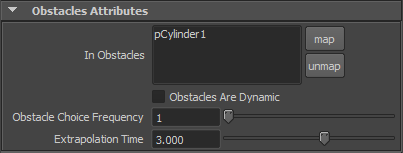

Obstacles Attributes
You can add additional steering constraints to flock, based on obstacles avoidance.
| In Obstacles | Maya meshes mapped to this field to will be avoided by flock |
| Obstacle Choice Frequency | Each boid will avoid nearest obstacle at such frequency. For free flights and random obstacles, a frequency of 1 to 3 should be sufficient. To constrain boids inside a given volume, the frequency must be higher (around 10) to detect properly the volume and to avoid flying through a face while avoiding the last detected one. This parameter will have to be set accordingly to max speed / acceleration and extrapolation time of the boids. |
| Extrapolation Time | Each boid will interpolate its current speed on the given time, to test if it intersects a mesh face. The closest intersection found, if any, will generate a repulsion base on the intersection face normal and current boid speed/direction. |

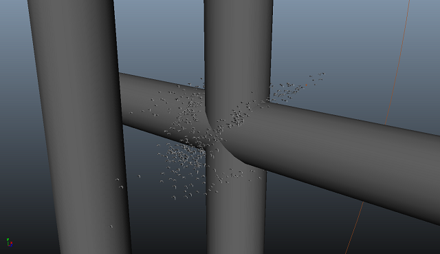

Obstacle avoidance is not a guaranteed constraint, due to its evaluation which only takes nearest face for a given duration (1/frequency). Though, increasing frequency can help having better results.
Maya Mesh flock avoidance
