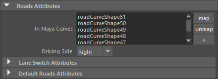

Roads Attributes
In Maya Curves Each of these curves define a road segment, with specific lanes information
Driver Side Set the driving side here (left or right)

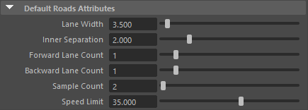

Default Road Attributes

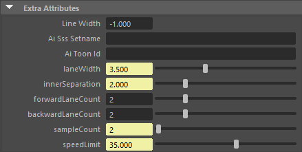

When curves are added to the Traffic Locator, some parameters are added to them to define their traffic properties. All these parameters can be tweaked per lane once the curves are added to the locator, in their Extra Attributes section.
Extra Attributes of a Maya Curve once mapped to a Traffic Locator
The default value of those properties is defined in the Default Road Attributes panel
Lane Width The width of a single lane (usually around 3 meters)
Inner Separation The separation between the right and left lanes which are the closest to the middle of the road
Forward Lane Count The lane count in the curve forward definition order
Backward Lane Count The lane count in the curve backward definition order
Sample Count The curve is sampled to build each lane. The sample count influence the smoothness of orientation and fidelity to the original curve.
Sample Limit Speed limit on this road.
