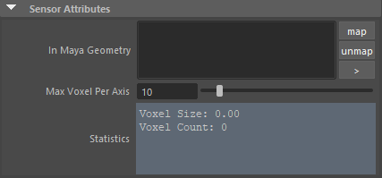

Sensor Attributes
In Maya Geometry
Maya meshes that define the sensor geometry. Several meshes or a transform containing one or more meshes can be mapped.
Caution:
Each Maya mesh must be closed, convex and its face normals must point outwards or the perception volume might be incorrect. A warning message is displayed in most cases when the mesh does not respect these prerequisites. There might still be some cases where the Sensor Locator does not detect invalid meshes. To make sure that the input geometry is valid, display the voxels (see the Display Attributes) and make sure they fill the inside of each mesh.
The sensor overall shape doesn't need to be convex, as long as it's made up of multiple individual convex meshes.
The geometry is considered X-front and Y-up. The (0, 0, 0) coordinate will be aligned to the position of the crowd entity.

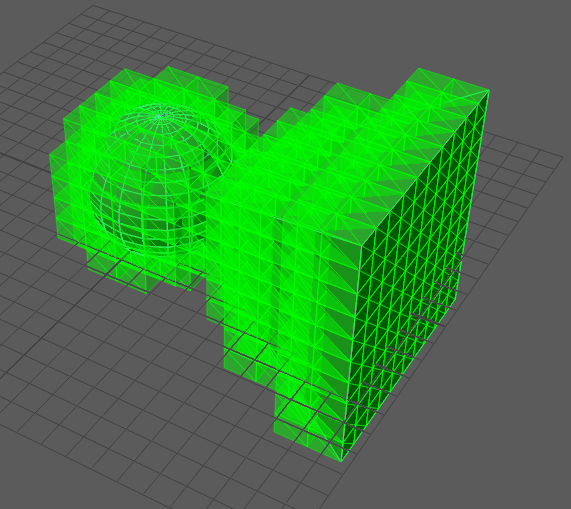

Max Voxel Per Axis
Max voxel count on the X, Y or Z axis. The Sensor Locator transforms the Maya geometry into a set of voxels, by taking its bounding box and dividing it into voxels. The size of each voxel on an axis is determined by dividing the size of the bounding box on that axis by the voxel count on that axis. A voxel is filled if its center lies inside the mesh shape.
Caution:
By increasing the voxel count, the input geometry is approximated more precisely at the expense of performance.
For performance reasons, the AABB tree structure is what is actually used to determine if an object is detected. Thus, for more precision, Max Voxel Count can be increased. Check the viewport display to visualize the voxels (see Dsiplay Attributes below).

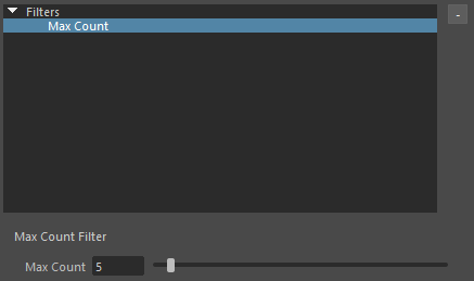

Max Count
Limits the number of detected objects to a given value.
Parameters
  • Max Count: the maximum number of detected objects

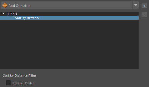

Sort by Distance
This is a special filter that does not exclude any object, but rearranges them based on their distance to the current entity.
Parameters
  • Reverse Order: reverses the sort order

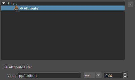

 PP Attribute
This filter is only valid if the detection type is set to Plain Entity. It lets you keep only entities having a PP Attribute that satisfies an expression.
Parameters
  • Value: defines the name of the PP Attribute, an operator and a value. The filter only keeps entities having a PP Attribute matching the value.

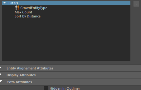

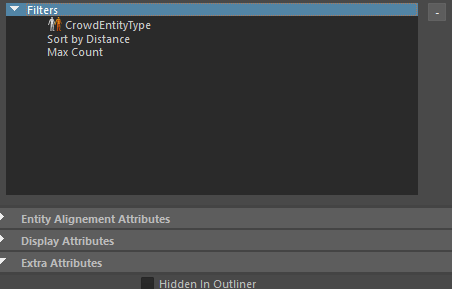

Let's say that we want to detect only the closest 3 entities of a given type, entityTypeShape1. To achieve this, we can use three filters, as shown below:
Example A Example B
In example A, the sensor first keeps only entities of type entityTypeShape1 (CrowdEntityType Filter), then keeps only the first 3 entities in the remaining list (Max Count Filter), and finally sorts the entities by distance (Sort by Distance Filter). In example B, the Max Count and Sort By Distance filters are switched, so the sensor first keeps only entities of type entityTypeShape1 (CrowdEntityType Filter), then sorts the resulting entities by distance (Sort by Distance Filter), and finally it keeps only the first 3 entities in the remaining list (Max Count Filter). As the initial list of detected objects depends on the shape of the sensor and is not ordered in any way, the two examples will produce different results. Only example B really works the way it is intended, and detects the closest 3 entities of type entityTypeShape1. Example A detects 3 entities of type entityTypeShape1 that are output in a list ordered by distance, but they are not necessarily the 3 closest entities of that entity type, as the Max Count Filter gets applied after the Sort by Distance filter.
Another way to obtain the same result would have been to create the filters in this order: Sort by Distance, CrowdEntityType, Max Count. However, this means that the Sort by Distance filter would be applied to all the entities in the perception environment, and not just on the entities of type entityTypeShape1, thus being more CPU intensive.

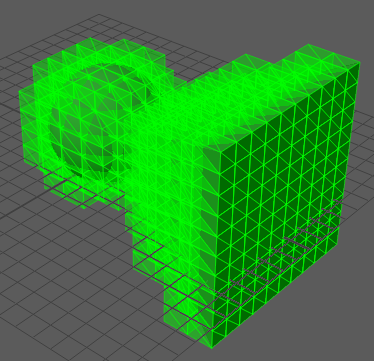

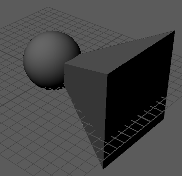

The examples in the table below were created using the Maya geometry in the image below.
Display Color Defines the color of the Sensor Locator in Maya's viewport.
Display Voxels
When enabled, draws the sensor voxels in Maya's viewport.
Display Voxels enabled
