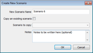

This dialog is displayed when you click:
Create Scenario
on the Scenarios toolbar.
- Create in the
Manage Scenarios dialog.
Dialog description
Item |
Description |
New Scenario Name |
The name for the new scenario. |
Copy an existing scenario |
If checked, the new scenario will be copied from an existing scenario. Tip: Copying a scenario is very similar to the Copy / Paste operation in Windows. The copied scenario is a duplicate of the original scenario but is completely independent from it. See
Important Note about the Structure of Scenarios for more information.
If unchecked, a new scenario is created from the base network. |
Scenario to copy |
Enabled if the Copy an existing scenario box is checked. The scenario to copy from can be selected from a dropdown list. |
Notes |
Information about the new scenario can be specified here (optional). |
OK |
Commits the changes and closes the dialog. |
Cancel |
Cancels the changes and closes the dialog. |
