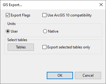

GIS Export (exporting from a network)
Dialog description
| Item | Description |
| Export Flags |
Check this option to export flag data. |
| Use ArcGIS 10 compatibility |
SHP file export only If checked, a direction check on polygons is performed to ensure that all exported single-part polygons are specified anti-clockwise. (Various features in ArcGIS 10 require single-part polygons to be specified anti-clockwise.) |
| Skip Empty Tables |
Geodatabase only If checked, empty tables will be excluded from export. |
| Units | Export using InfoAsset Manager Native Units / current User Units |

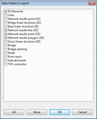

| Select tables |
If checked, export is restricted to a selection of tables. The tables to be exported can be selected when you click Tables. This displays the Select tables to export dialog.
Check the boxes next to the tables to be exported. Use the All and None buttons to select or deselect all tables in the list. |
