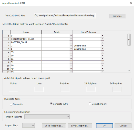

Import from AutoCAD Dialog
This dialog is used when Importing from AutoCAD DWG files.
It is displayed when ImportImport data from AutoCAD DWG is selected from the Network menu.
Note: This option is only available for 64 bit versions of InfoAsset Manager.
Dialog description
Dialog Field
Description
AutoCAD DWG File
Displays the path of the DWG file to be used for import. Click Browse to select the file from a Window File Open dialog.
Layers Grid
The grid displays all layers in the selected DWG file. The grid is made up of three columns:
Grid Column
Description
Layers
Layer name.
Points
Dropdown list of network objects.
Select the network object, that the AutoCAD points are to be imported as, from this list.
Lines
Select the network object, that the AutoCAD lines are to be imported as, from this list.
AutoCAD objects in layer
Displays the number of each type of AutoCAD object in a layer highlighted in the Layers Grid.
Duplicate Items
There are three options for dealing with duplicate items:
Option
Description
Overwrite
Duplicate items will be overwritten (default).
Generate suffix
Append a suffix to the Object ID of duplicate items (#1, #2, etc.).
Do not import
Duplicate items will be ignored and not imported.
Lines annotated with text
Dropdown list containing all the available fields that annotations can be imported into.
Permitted values are Length and user text and user number fields.
Default is blank (no annotation import).
Import Flag
Dropdown list containing the available user-defined flags.
Select a user defined flag for imported data.
Load Mappings
Load previously saved Point and Line mappings from AutoCAD configuration file into the Layers Grid.
Save Mappings
Save Point and Line mappings in the Layers Grid as an AutoCAD configuration file.
