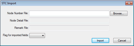

STC25 Import Dialog
This dialog is used when importing manhole survey data from STC25/26 data files.
Show me
The dialog is displayed when Import | Import Manhole survey data | Import STC25 manhole survey data is selected from the Network menu.
Import STC25/26 files
- Click Browse to find the Node Number (.NDE) file. InfoAsset Manager will automatically include other data files as long as they follow the STC25 naming conventions.
- Click OK to continue with the import process.
