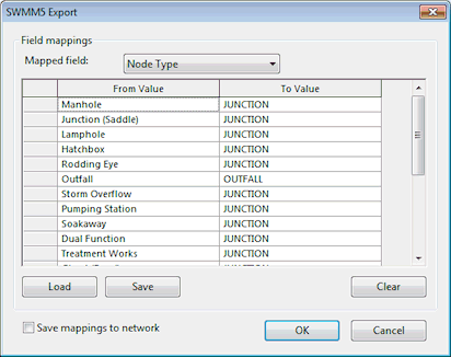

This dialog is used to set up mappings between InfoAsset Manager and SWMM5 values.
The InfoAsset Manager fields that can be mapped are:
- Node Type
- Pipe Shape
- Pump Type
- Weir Type
The first time a network is exported, the mapping settings will be set to default settings.
Check the Save mappings to network box to store the settings in the network preferences so that the settings used when exporting the network will be available the next time the network is exported. (This option is disabled when exporting a previously committed version of the network.)
Settings can be saved to a .cfg file. The .cfg file can then be loaded into the Export Dialog for use when exporting a different network for example.
The Clear button clears the values in the To Value column.
