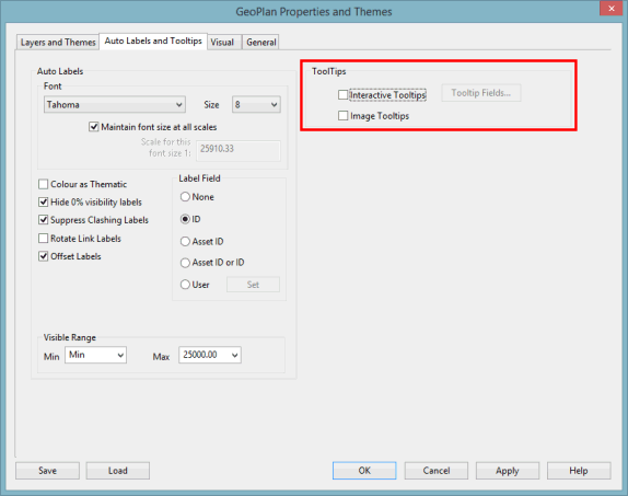

To access settings for tooltips
  • Right-click on the GeoPlan
  • Select Properties & Themes
  • Select the Auto Labels and Tooltips page

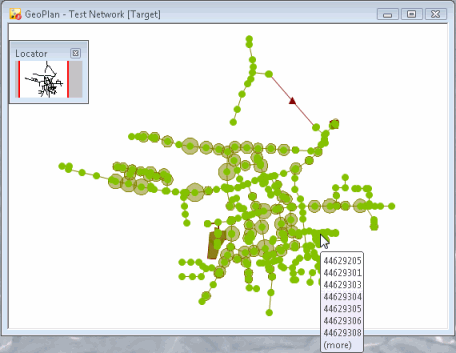

Default tooltips
By default, GeoPlan tooltips display the object ID. When hovered, objects are listed vertically, and are presented in a list that is truncated before 80 characters are reached, and the text more appended at the end.
Example of default tooltips in InfoWorks ICM

These are switched on by checking Interactive Tooltips in the Auto Labels and Tooltips page of the GeoPlan Properties dialog.
It is possible to customise which fields will be displayed in tooltips.
When you click Tooltip Fields, the ToolTip Field Settings dialog is displayed. From there, select the network object fields to be displayed in tooltips.

These are switched on by checking Image Tooltips in the Auto Labels and Tooltips page of the GeoPlan Properties dialog.
