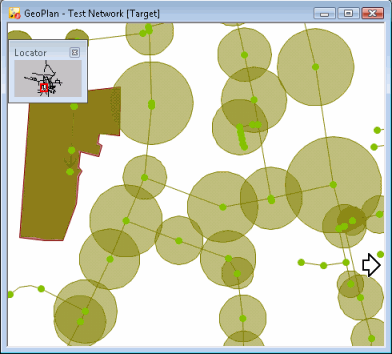

With the option enabled:
  • Large arrows appear when you move the cursor close to the edges and corners of the GeoPlan.
  • Click with the left mouse button to scroll the view in the direction indicated.
  • Click and hold the left mouse button to scroll repeatedly in the direction indicated.
GeoPlan with Automatic Panning Cursor visible on the right
