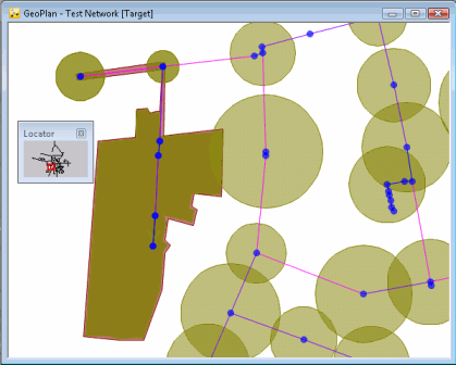

The GeoPlan Locator Map allows you to pinpoint your exact location within a network. This can sometimes be difficult when you are zoomed in on a specific area. You can also use it to pan around the network, making it easy to move around the whole network quickly.
The locator map displays a simple schematic of the entire network, with a highlighted box displaying the current location of the GeoPlan Window in relation to the network as a whole. It can be turned on and off using the Show Locator Window option on the GeoPlan tab, which is accessed from the ToolsOptions menu. The GeoPlan needs to be closed and re-opened to implement the change.
The locator map must stay within the GeoPlan window, but it can be resized and positioned within that window in the same way as you would move or resize any other window.

GeoPlan Window displaying the Locator Map
