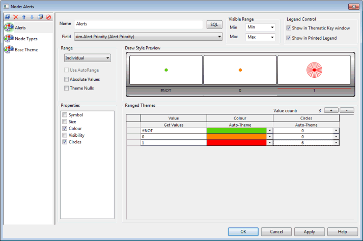

  8. Enter Alerts in the Name box of the blank Sub Theme Editor Pane that gets displayed.
  9. In the Field dropdown, select sim.Alert Priority.
  10. Then set the theme as shown in the screenshot below, remembering that the priority for this particular alert is 1:
    1. Set the range to Individual.
    2. Add a third value by clicking on thePlus button button of Value Count and set that value to 1.
    3. Change the colours so that they match the ones shown in the screenshot below.
    4. Enable the Circles property.
    5. Set the number of concentric circles to 6 for the highest value (1).
  11. Setting an alerts theme
  12. Click OK to save your changes.

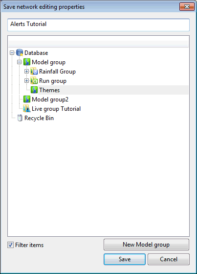

    3. The Common Tree Selection dialog gets displayed. Navigate to the Themes model group, type in Alerts Tutorial in the box at the top and click Save.
    4. Common Tree Selection Dialog

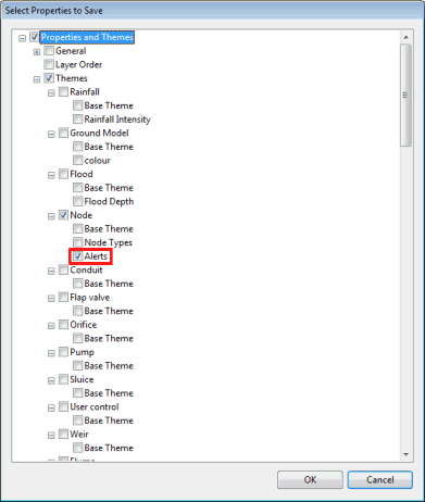

    5. The Properties to save dialog is launched. Unselect the first entry (Properties and Themes) and enable the Alerts node theme.
    6. Selecting the Properties and Themes to save
    7. Click OK, the dialog closes.

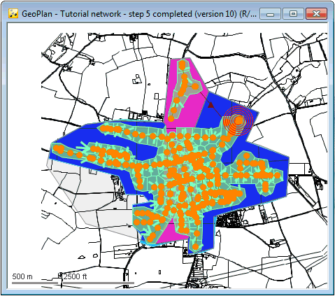

  18. The Alerts theme is applied to the GeoPlan. Click the Show maxima button () of the Replay toolbar to display the maximum results values:
Alerts theme on GeoPlan
