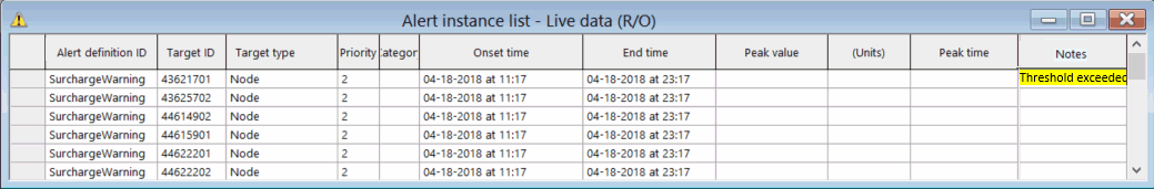

Alert Instance list grids are read-only and all the fields are auto-generated from the alert definition from which the alert instances were created.
Alert Instance List

Field
Description
Alert definition ID
The name of the alert definition, identifying the type of event occurring in the network, e.g. critical pressure.
Alert definition IDs are specified in Alert Definition Lists.
Target ID
The object identifier.
If the object does not have an Asset ID, the Object ID will be displayed instead.
Target type
The type of object that the alert applies to, e.g. conduit, subcatchment.
Priority
Priority of the alert (integer)
Category
Category of the alert.
Onset time
Simulation time at which the event that triggered the alert first started.
End time
Simulation time at which the event that triggered the alert ended.
Peak value
The peak value for the event that triggered the alert.
Units
The units of measurement for the peak value. This will be the same as the currently selected Unit.
Peak time
The time that the peak value was reached.
Visibility
Inherited from the related Alert Definition.
Not visible to the user in the grid.
Notes Information about the alert that was added in the Alert Definition List. If only part of the note is visible, click on the field to open the Notes window where the entire note can be viewed.

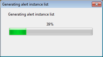

  2. Drag and drop the desired Alert Definition List onto the GeoPlan. A dialog shows the progress of the operation as alert instances are being generated.
  3. Alert Instance List generation
