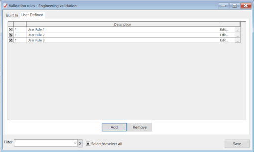

User Defined
The User Defined tab allows user defined validation rules to be created using a simple syntax similar to SQL statements. InfoWorks ICM includes an editor that allows you to easily build up your own rules without any knowledge of SQL.
A new rule is created by clicking the Add button. This automatically displays the Validation Rule Editor dialog. For more information on editing your own rules, see . Clicking the Remove button deletes a rule.
Once you have created your user defined rule you can:
- Switch the rule on or off using the check box on the left of the row.
- Edit the rule by clicking on the Edit button on the right of the row to display the Validation Rule Editor dialog.
