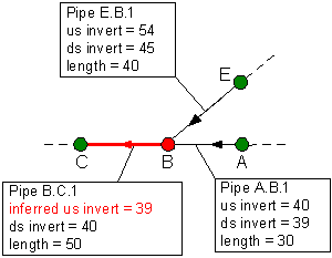

Direct Inference from Connected Conduit Invert
If there is a single connected conduit with known invert level at the location of the invert to be inferred, the invert level at the connected end of the conduit will be used.
If there are multiple connected conduits with known invert levels at the location of the invert to be inferred; the invert level at the connected end of the shortest conduit is used.
Click on the image below to show the example.

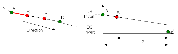

Inference by Linear Interpolation
The invert level of a conduit is inferred by linear interpolation between known upstream and downstream inverts:
- Step 1: For each conduit with missing invert levels, the system searches upstream and downstream for the closest known upstream and downstream invert levels (including invert levels of the conduit for which values are being inferred).
- If there are multiple known invert levels at the same distance, the lowest value is taken.
- If there is a current selection of conduits, invert levels of selected conduits will be used in preference to invert levels of non-selected conduits.
- Step 2: Missing invert levels are calculated using linear interpolation between the known upstream and downstream invert levels found in Step 1.
Example
- A run of conduits A-D has unknown invert levels at B and C.
- Conduit AB is selected for inference
- The Interpolate from Inverts rule searches upstream and downstream to find the known inverts:
- US Invert Level of conduit AB
- DS Invert level of conduit CD
- The DS Invert Level of conduit AB is calculated as:
D + [x *(D-A)]/L
where:
D = DS Invert Level of conduit CD
A = US Invert Level of conduit AB
x = Distance from downstream node of conduit AB to node D
L = Total Length from node A to node D
