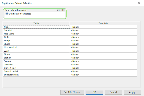

This dialog is used to select the templates stored in a Digitisation Template to be used for setting default values when new network objects are created.
It is displayed when Digitisation defaults is selected from the Tools menu.
Drag the Digitisation Template containing the templates to be used for setting default values into the Digitisation Template selection box.
The template to be used for each network object may be mapped to an object type by selecting from the dropdown list in the Template column of the grid. Each dropdown list contains only those templates from the selected Digitisation Template that correspond with the object type in the row.
Click:
- Set All <none> to clear existing mappings and set all fields to <none> (Template mappings are remembered from previous use of the dialog.)
- OK to apply changes made to template mappings and dismiss the dialog.
- Cancel to undo any changes made since the last time changes were applied and to exit the dialog
- Apply to apply all changes made to template mappings
Once the templates have been mapped, they will be used when creating all new objects as long as the Initialise New Objects with Digitisation Default Values box on the General Page of the GeoPlan Properties dialog has been checked.
