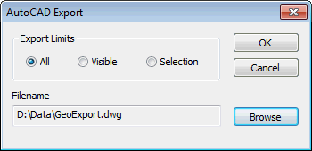

To export a GeoPlan to DWG format
- Select Export to AutoCAD DWG from the GeoPlan menu. This displays the
AutoCAD Export dialog.
- In this dialog, select export options as required:
Export Limits:
- All - export all objects in InfoWorks ICM network layers in the GeoPlan Window that have display turned on
- Visible - export all objects displayed in the GeoPlan Window within the constraints of the current zoom
- Selection - export currently selected objects only
Export Limits:
- Choose a location to which to save the exported file. Either type in a path in the Export Filename box, or click Browse to find a location.
- Click OK to export the file.
