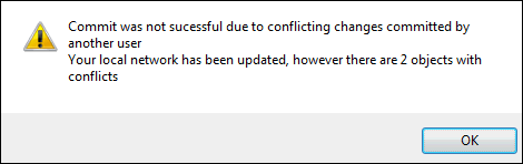

If conflicts occur when you get other users' changes, your local database will be updated and you will see a message showing you how many objects have conflicts.
Example of warning message displayed when there are conflicts
