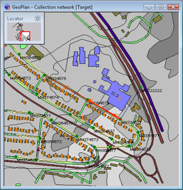

The network and GIS data
In this example we are looking for large damaged pipes in difficult ground. Specifically we are going to select any such pipes near a hospital, as a failure in such a pipe could be a major problem.
Figure 1 shows the area of interest.
- Soil types are contained in a GIS Layer and shown in different shades of grey.
- Roads, river channels, and buildings are contained in a different GIS Layer and show up using various colours
- The underlying pipe network is not easy to see in this example, but this doesn't matter
The various roads and buildings of interest are described in the stages below.

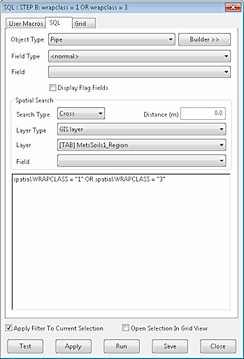

The second SQL object refines the selection made by the first SQL object. Note that Apply Filter to Current Selection is checked. This limits the network objects to which the SQL is applied to those already selected. This is a powerful feature.

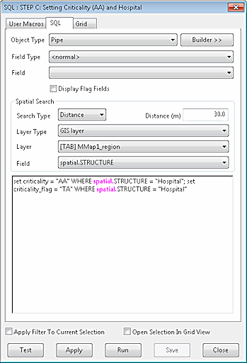

Next, we test our selected pipes to see if any of them is near a hospital. A pipe collapse near a hospital that blocked access or released wastewater in the area would probably be a major problem, and therefore repairing damaged pipes in this sort of situation will be more critical than elsewhere.
