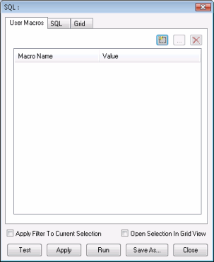

The User Macros tab on the SQL dialog lets you create variables for representing values within the query. These variables are called macros.
Click on the
button to create a new user macro. The
Macro dialog is displayed. Enter a name in the Title box and a Value, then click on OK.
To change the macro's value or name, either double-click on an existing user macro or click on the macro and then on the
button. Click on OK to confirm the changes.
Click on an existing user macro and then on the
button to delete the user macro.
