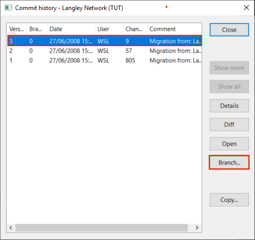

- Right-click the Langley Network (TUT) network in the Explorer window, and select Show commit history from the pop-up menu, and a Commit history window is displayed.
- Select the version at the top of the list and click Branch.
- Name the network 'Langley Catchment - New Estate'. Click OK.

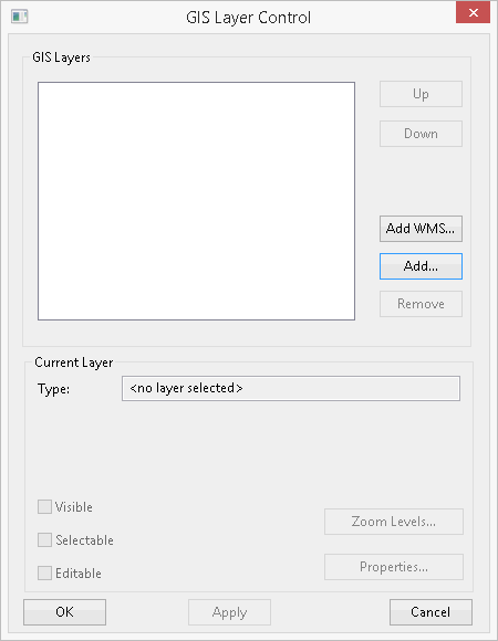

- Right-click the GeoPlan and select GIS Layer Control from the pop-up menu. The
GIS Layer Control dialog is displayed:

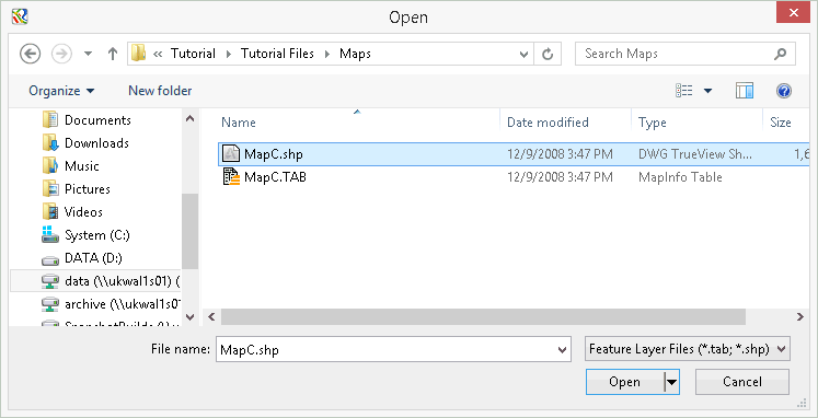

- Click Add, and then in the
Open window, browse to 'Tutorial File/Maps' and then select the 'MapC.shp' file.

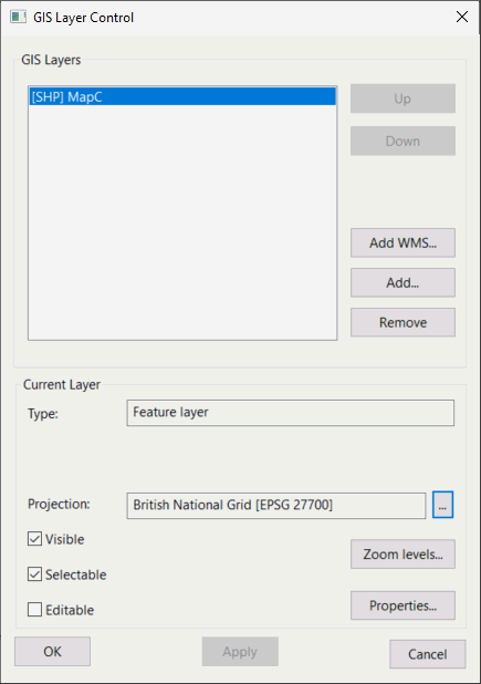

- Click Open and the
Open window closes. The selected 'MapC.shp' file is now displayed in the GIS layer pane of the
GIS Layer Control dialog.
- Select Apply and then OK to save the changes the map layer. The GIS Layer Control dialog closes and the background map is displayed in the GeoPlan.

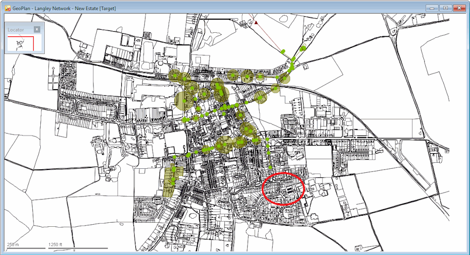

- Zoom to the new estate. This is highlighted on this GeoPlan example:
Note that there are currently no nodes or links serving this area of the network.

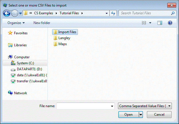

- Click OK to use the default values for the import operation. You are now requested to select the CSV files to import:

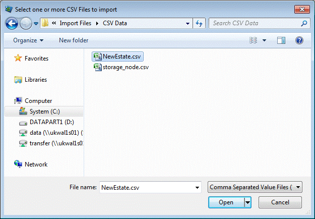

- From the Example Data Directory, select 'Tutorial Files/Import Files/CSV Data/NewEstate.csv' and click Open.
The selected 'NewEstate.CSV' file is imported. It is possible to import another CSV file but this is not required.

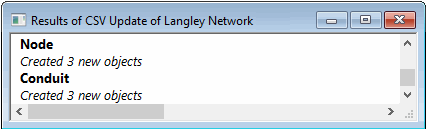

- Click Cancel to close the window. A window is displayed, detailing the number of objects (nodes and links) that have been created.

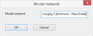

A New Database Item dialog is displayed. In this window:

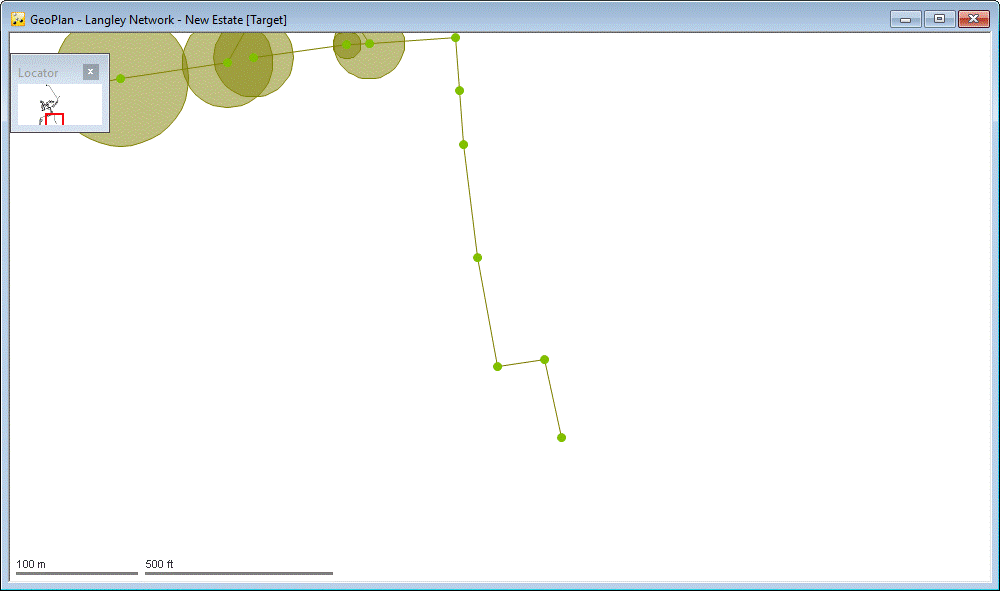

You can now see that the imported data forms a small network connected to the existing network:
