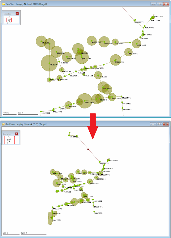

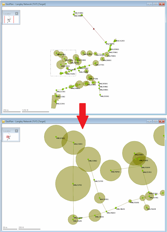

Zoom in
To zoom in, click the
button on the toolbar and then click anywhere on the GeoPlan to zoom in on part of the network. The pointer changes to a
. Each time you click the network, you will increase the magnification, with the display centred on the point where you clicked. You can also zoom onto a particular area by holding the left mouse button and dragging the pointer to make a box around the area that is to be magnified.
Zoom out
Click the
button on the toolbar and then click anywhere on the GeoPlan to zoom out from part of the network. The pointer changes to a
. Each time you click the network, you will decrease the magnification, with the display centred on the point where you clicked.

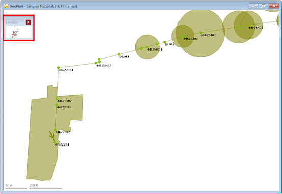

Locator Window
The area shown on the GeoPlan is represented by a red rectangle on the Locator window.
Drag the rectangle to a different place on the Locator window to display the corresponding part of the network in the GeoPlan. Move the Locator window around the GeoPlan by dragging its title bar.
