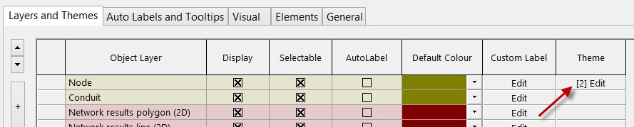

- Click the Node/Theme cell in the Layer and Themes tab.

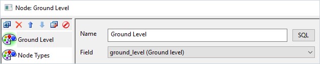

- Change the default name of 'New Sub1' to an appropriate name, such as 'Ground Level' in the Name field.
- Select 'ground_level' from the Field drop-down list.

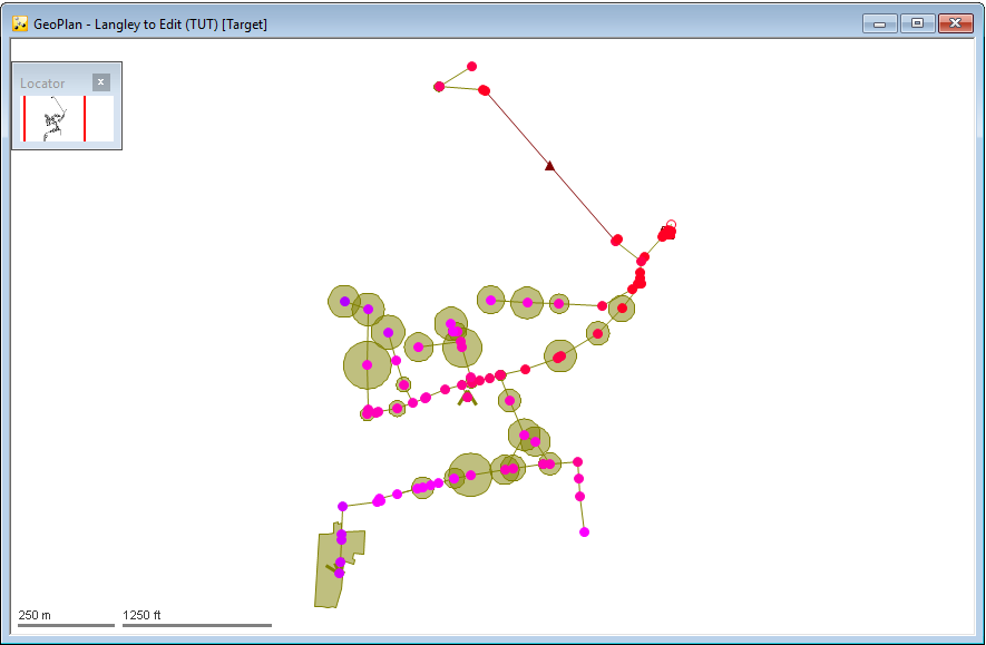

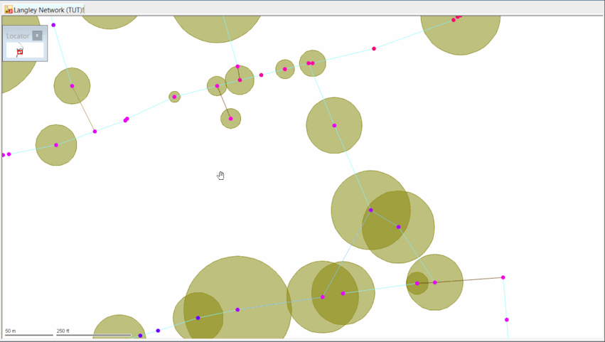

Click OK in the GeoPlan Properties and Themes window. You can now see that the lowest point in the network is in the north east, with the highest point in the west. The circle at the lowest point represents the outfall node.

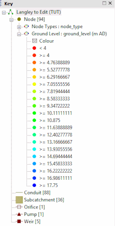

Thematic key window.
You will need to expand the Node theme to see the theme you just created for the ground levels.

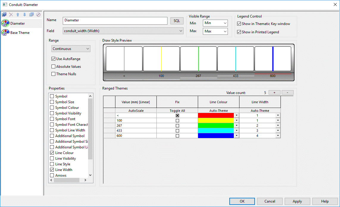

Pipe diameter
- In the GeoPlan Properties and Themes dialog click the theme for Conduit.
- Add a new theme, call it 'Diameter', and from the Field drop-down list, select 'conduit_width'.
- Check that the Range is set as Continuous and that the Use AutoRange check box is selected.
- Turn on the Line Colour and Line Width in the Properties pane.
- Enter 5 for the Value Count:.
- Choose a colour for each range and select a Line Width for each bar.

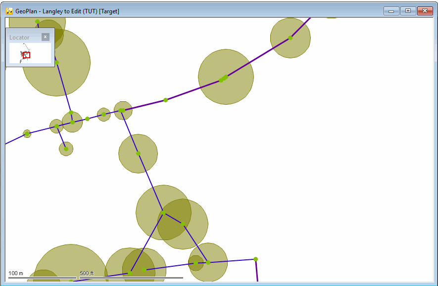

- Apply the theme Click the OK button in the Theme Editor window and then click the OK button in the GeoPlan Properties and Themes dialog.
- Use the GeoPlan tools to zoom in on part of the network, and you should see that the different pipe thicknesses are now represented in the selected colours.

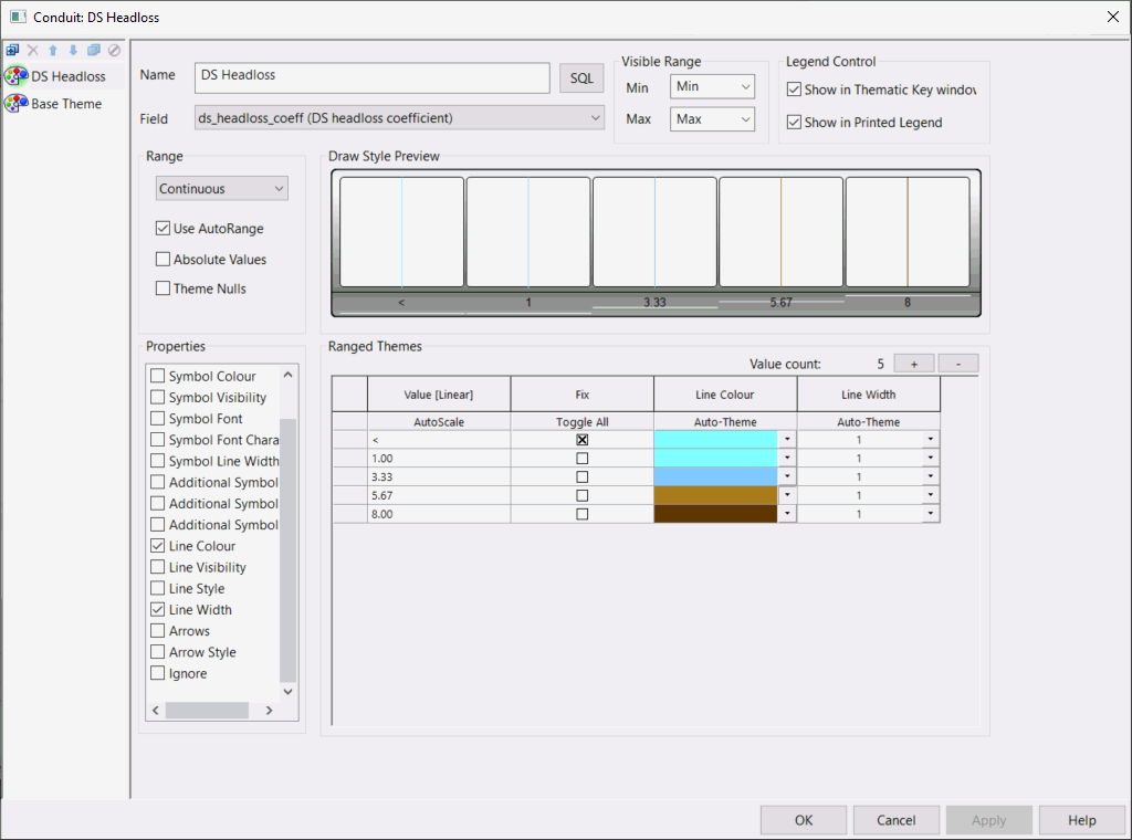

Downstream headloss coefficient
- In the GeoPlan Properties and Themes dialog, click the theme for Conduit.
- Disable the Diameter theme.
Select the theme in the right-most pane and click the Disable/Enable button (
) in the toolbar.

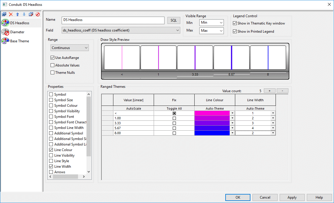

- Add a new theme, call it ‘DS Headloss’, and from the Field drop-down list, select 'ds_headloss_coeff'.
- Choose a colour for each range.
- Select a Line Width for each bar.
- Use the GeoPlan tools to zoom in on part of the network, and you should see that the different downstream headloss coefficients are now represented in the selected colours.
