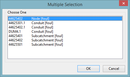

- If you are close to more than one object, the Multiple Selection dialog is displayed, showing the labels of the nearest objects.
- Click one of these and then click OK and the appropriate object is selected.

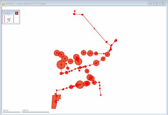

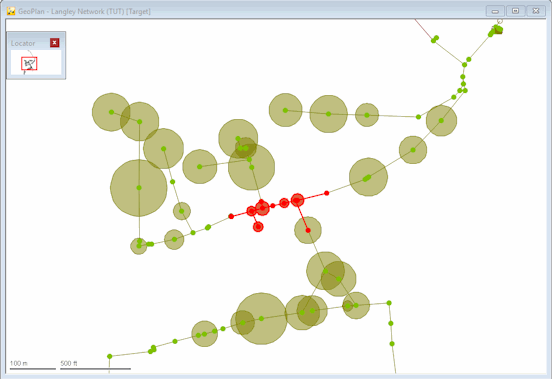

Polygon Select
The Polygon Select tool enables you to select all network objects within an area. Click the
button on the
GeoPlan Tools toolbar and move the pointer to the GeoPlan. Note that the pointer changes to a cross.
- Single click to start creating the selection area. The cursor is now connected to the point where you clicked with a red line.
- Continue to single click to build up the selection area.
- Double click to link to the starting point and close the area. A network object is selected if its centre point falls within the selection area.

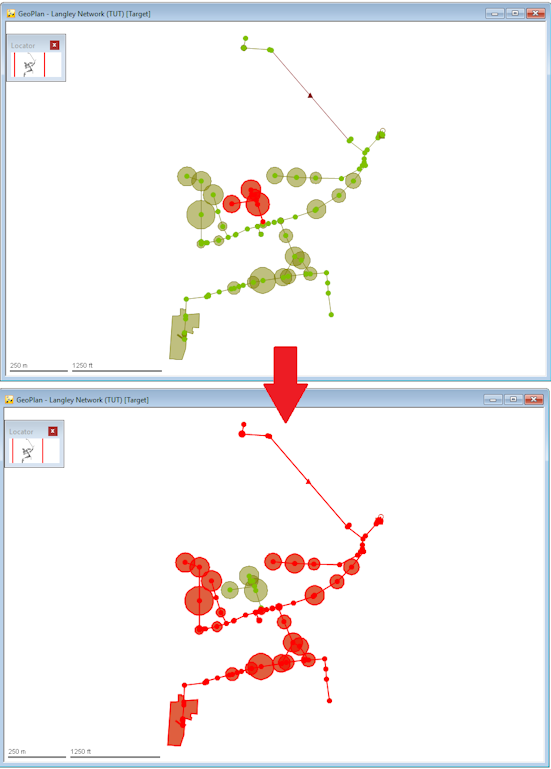

Select All / Clear Selection
The 'Select all objects' tool enables you to select all the objects on the network. Click the
button on the
Selection toolbar.
The 'Clear selection' tool clears the current selection. Click the
button on the
Selection toolbar.
Both these functions are also available via the Selection menu.
Invert Selection
The 'Invert current selection' tool enables you to de-select all objects that are currently selected, and select all those that are currently not selected. Click the
button on the
Selection toolbar to invert the current selection. This functionality is also available via the
Selection menu.

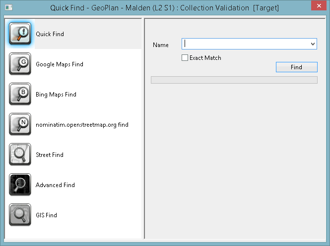

Finding Objects
Find specific network objects
- Click the
(Find in GeoPlan) button on the
GeoPlan Tools toolbar, and the
GeoPlan Find
dialog is displayed.
Type part of the object name in the Name box and click Find. If you do not want to find the closest match to what you have typed, you can click the Exact Match check box to narrow the search to network items with the exact name used in the search.

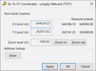

Find a point from its coordinates
You can find any point in your model by entering their XY coordinates and, if necessary, change the zoom level to zoom in or out centred on that point.
- Click the
button (Go to XY coordinates) on the
Go to XY Coordinates dialog is displayed.
- Type in the coordinates of the point you want to find. The dialog gives you some help by showing the maximum and minimum coordinates in the network.
- Choose a zoom level. The value given is the shortest distance across the GeoPlan View. This is likely to be the top to bottom distance but may vary depending on the window shape and the aspect ratio. Click OK to zoom in or out to the chosen level, centred on the chosen coordinates.
- If you want to find the address for the coordinates, click the Show button to display the Address lookup options. See Find and Zoom Using XY Coordinates for further information about finding an address.

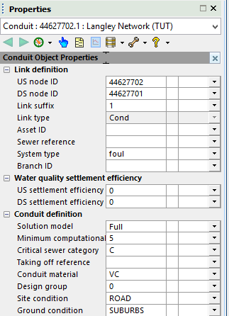

Displaying object information
- Click the
(Properties) button on the
GeoPlan Tools toolbar and then on an object in the network. As you move around the network, labels that identify the objects will pop up.
The property sheet for the selected object will be displayed. For example:
