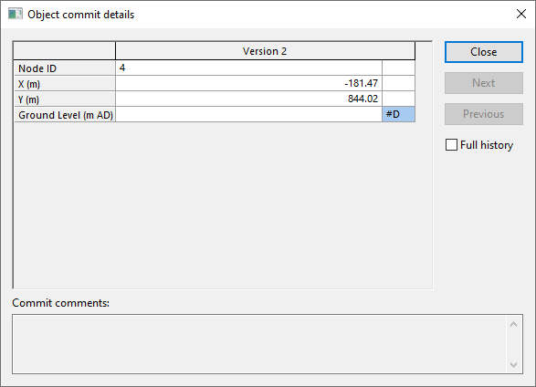

Object commit details dialog
This dialog provides details of any previous commit, such as object ID, number of changed objects, and any comments made at the time.
The dialog is displayed when you click the Details button on the Commit History dialog when viewing the commit history of a specific version.
Item Description
Close Closes the dialog. You are not prompted to save changes made to the comment text.
Next Shows the details for the next commit, as listed in the Commit History dialog.
Previous Shows the details for the previous commit, as listed in the Commit History dialog.
Full history Shows the full history of the commit, which includes details about the previous versions.
