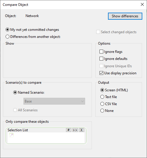

Compare Object dialog
The dialog can be used to compare two versions of the same version controlled object, your local copy of the version controlled object with the latest version in the database, or two separate version controlled objects.
Note: If you want to compare arbitrary versions of the same network or controls derived from the same network, it is recommended you make use of the functionality available in the Commit History dialog.
Item Description
Object
Read only text naming the version controlled object from which the dialog was opened.
My not yet committed changes
This option allows you to compare the last committed version of the object with the current version of the same object for which changes have not yet been committed.
Differences from another network
This option allows you to compare two random version controlled items of the same type.
Enables the Show section (see below).
Show
Available when Differences from another network is selected.
Allows you to specify the version controlled object that will be compared with the originally selected object.
You can drop an object into this box, or use the Browse (Browse) button to browse for the item.
Note: An object cannot be compared with another version of itself using this dialog. The Commit History dialog should be used for such a comparison.
Select changed objects
This option is available when a GeoPlan of the object to be compared is open.
If ticked, selects on the GeoPlan all objects for which differences are found.
Scenario(s) to compare
Use this section if you want to list the differences for a particular scenario or for all scenarios.
This section is enabled if the version controlled item in the Show box is a network and if scenarios exist for this network.
Select a scenario using the Named Scenario check box and the drop-down list underneath, or check the All Scenarios option to compare all the current scenarios for the selected network.
Only compare these objects
You can drag and drop a Selection List into the box or use the Browse (Browse) button to browse for a selection list. Only those items in the selection list will be compared.
Alternatively, you can click the Select version (Current) button to compare all objects currently selected on the current GeoPlan window.
Options
These options are ignore conditions that can be used to filter out specific changes during comparison. You will be warned if any network objects have been changed but not reported, due to any of these options being selected.
Ignore flags - Omits details of changes made to flags.
Ignore defaults - Omits details of changes in defaulted fields (fields that are flagged #D) from the comparison report.
Ignore Unique IDs - Omits details of changes to unique IDs.
Use display precision - Ignores differences that are below the level of precision shown in the property sheets or grids.
Output
Sets the destination for the report:
  • Screen (HTML)- Lists the differences between the version controlled objects in an HTML format.
  • Text file - Lists the differences between the version controlled objects in a text file, saved to a specified path.
  • CSV file - Lists the differences between the version controlled objects in a CSV file, saved to a specified path.InfoWorks WS Pro creates a CSV file of similar format to that created if a version controlled object is exported to a single CSV file, with the addition of an Action column.
  • None - Highlights the changed objects on the GeoPlan without an output file being produced. The Select changed objects option must be checked for this to work.
Show differences
Starts the comparison process.
