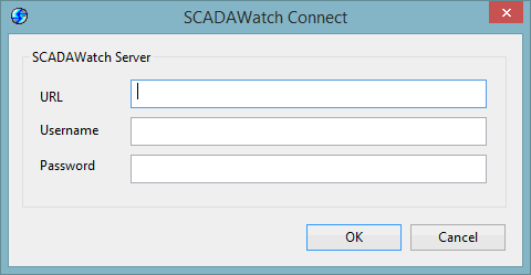

Specify connection details when using SCADAWatch as a telemetry source and live data logon view, live data feeds view, and live data view from SCADAWatch.
This dialog is displayed when:
- The SCADAWatch Connect option is invoked on the Tools menu.
- You click
(SCADAWatch Connect) on the Tools toolbar.
Tip: The menu option and toolbar button mentioned before, are only enabled if a checked out
Live Data Configuration object is open in the main window.
| Option | Description |
| URL |
SCADAWatch server URL. If
http://demo.server/scadawatchis the address of the SCADAWatch server appearing in your web browser, /api/should be appended to the end of it . In our example, this box should read http://demo.server/scadawatch/api/. |
| Username | Username to log on to database on server. |
| Password |
Password to logon to database. The password will be displayed as dots. |
See Connecting to SCADAWatch Telemetry for more information.
