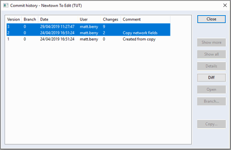

Compare a network with a version in its previous commit history:
  • On the Model Group window, right-click the 'Newtown Edited' icon and choose Show commit history from the context menu.
  • In the commit history dialogue, hold Ctrl and select the two versions to be compared.
    Network compare selection

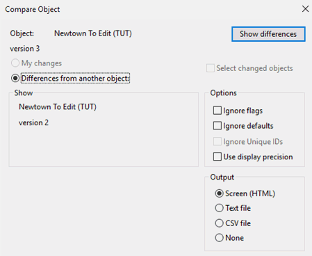

  • Press the Diff button to open the Compare Object dialogue. Accept the defaults and click Show differences.

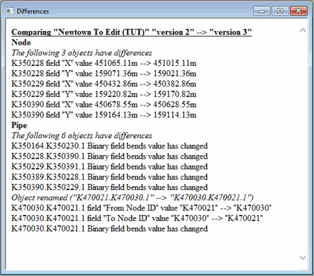

  • Network compare object
  • The comparison report is displayed in a text window and lists all the changes that have been made for each type of object.The table includes a number of changes to default values; for example, where nodes were moved, bends have been recalculated.
    HTML Comparison Report

  • On the Model Group window, right-click the 'Newtown Area Re-zoned' network icon and choose Compare from the context menu.
  • Click the Differences from another object check box and select the original Newtown network from the explorer tree.
  • Compare Object
