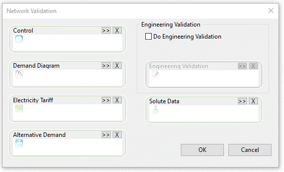

    • Select Validate network from the Network menu.
    • The Network Validation dialog is displayed. If you click OK, the network is validated to make sure you can run a simulation with it.

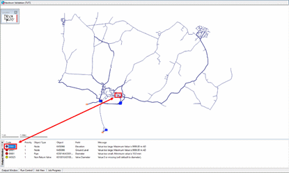

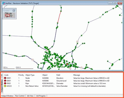

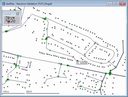

    • The network is validated and the Output window is displayed. There are 4 errors. Objects causing errors are highlighted in red on the GeoPlan.If necessary, you can change the column widths by dragging the column dividers to right or left.
      Show image
    • Output Window
  1. Correct the errors:
    • Click the E9001 code for node K450066 and the object causing the error will be highlighted in red on the GeoPlan.
    • You can, if you prefer, single-click a message to highlight the corresponding object on the GeoPlan. Right-click the GeoPlan and select Find selection. If you double-click an error code, the appropriate grid view is displayed, with the object causing the error highlighted.

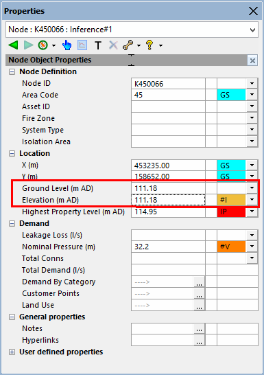

      Selecting the node related to an error message

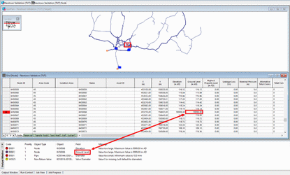

    • Select the Properties tool Properties from the Tools toolbar and click the node. The node properties are displayed. The ground level and elevation are shown as 99999 m, which is clearly wrong.
    • Check the ground level and elevation of the node immediately to the north (K450032). This is shown as 111.18 m. Redisplay the node properties for K450066, click the Ground Level field and change the value to 111.18 m. Enter the same value for the elevation.
      Editing the Ground Level and the Elevation for the node generating an error at validation time

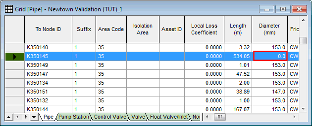

    • Double-click the last E9001 error message, so that the Link grid is displayed. The highlighted pipe has a diameter of 0 mm. The row immediately below shows that the other pipe for which the 'From' node is K350145 has a diameter of 153 mm. Five rows below, the pipe with a 'To' node of K350144 also has a diameter of 153 mm. Replace the 0 mm value by clicking the Diameter cell and entering a value of 153 mm. Close the grid view by clicking the Close button. You can change the way the records in the grid are displayed. For example, you can resize the columns or sort the grid according to the contents of a selected column. See Working with grids and property sheets for more information.
      Investigating a diameter of zero

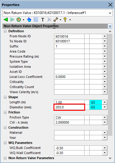

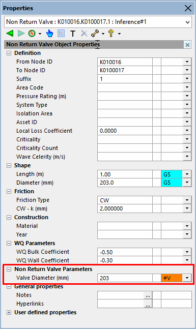

    • Click the E0325 error and find the non-return valve on the network. Use the Properties tool to display the valve's properties. The pipe Diameter is shown as 203 mm.
      Diameter of the Non Return Valve
    • In the Non Return Valve Parameters section, change the Valve Diameter from 0 to 203 mm.
      Editing the Non_Return Valve Diameter
