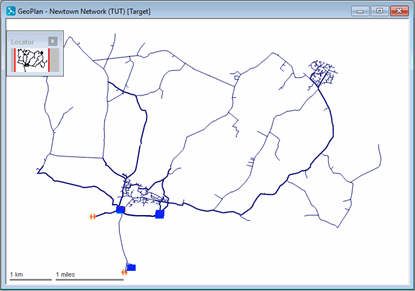

    • The network is displayed in the GeoPlan view ready for editing.
      GeoPlan with the network

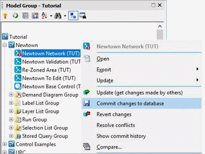

  3. To commit a network:The icon for checked-out networks has a red border.
    • Right-click the uncommitted network icon in the Model Group window and select Commit changes to database.

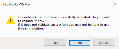

    • Do not validate the network at this stage (that is, click No on the following message).
      Validation warning
