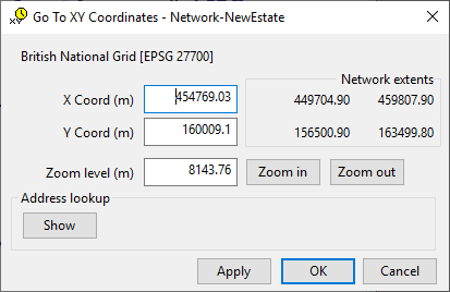

Find a point from its coordinates
You can find any point in your model by entering its XY coordinates. You can choose to zoom in or out, centred on that point.
  • With a network displayed in the GeoPlan, click the Go to XY coordinates (Go to XY coordinates) button on the Operations toolbar.
  • This displays the Go To XY Coordinates dialog.
    Go to XY Coordinates dialog
  • Type in the coordinates you want to find. The dialog gives you some help by showing the maximum and minimum coordinates in the network.
  • Choose a zoom level. The value given is the shortest distance across the GeoPlan view. This is likely to be the top to bottom distance, but may vary depending on the window shape and the aspect ratio.
  • Click OK to zoom in or out to the chosen level, centred on the chosen coordinates.
