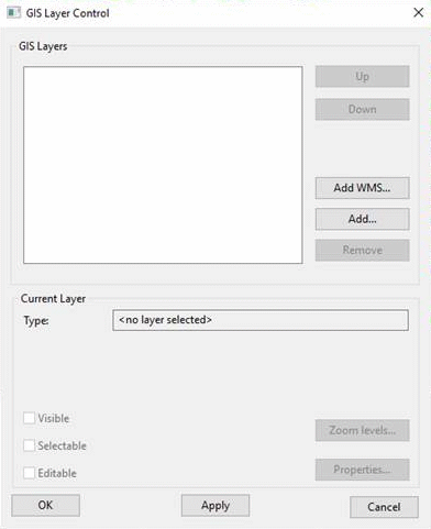

  • Right-click anywhere in the GeoPlan window and select Layer control.
  • The GIS Layer Control dialog is displayed.
    This screenshot shows that there are currently no layers that have been added to the network. When some layers are added, their names appear in the white area.

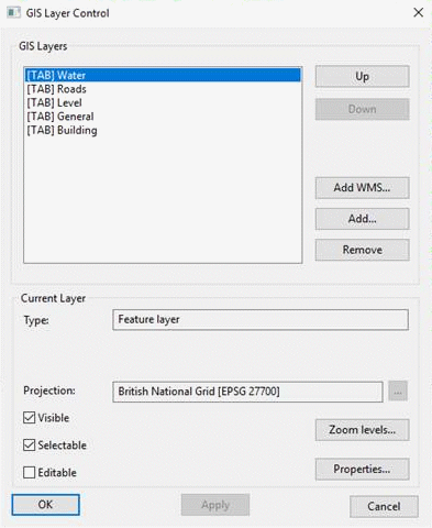

  • Click the Add button, select all of the files in the Tutorial Files/Maps/ArcView directory from the Example Data Directory and click Open.
  • The new layer(s) is/are added to the dialog.

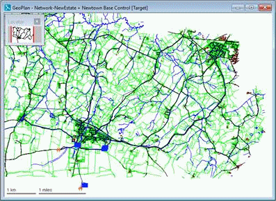

  • Click OK to close the GIS Layer Control dialog. The GeoPlan is redrawn with detailed maps behind the network. These maps allow you to see where the network elements are in relation to features such as roads, buildings and rivers.
    Network with background layers in GeoPlan view
  • You may add other layers, in which case the order of layers is as shown in the GIS Layer Control dialog and can be changed.

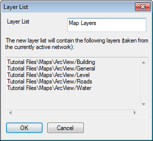

  • Right-click Layer List Group in the Model Group window and select New | Layer List. If there is no layer list group, right-click the top icon in the Model Group window, and choose New | Layer list group.
    Layer List dialog
  • In the Layer List dialog, type a relevant name for the list and click OK.

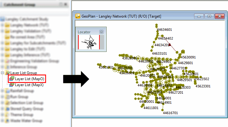

  • Later, if you have removed one or more of the layers from the GeoPlan, you can restore them all by opening this layer list or dragging it onto the GeoPlan.
    Restoring a layer
